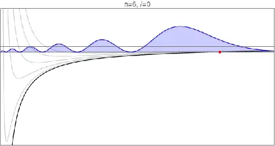

Radial hydrogenic wavefunctions for n=6 and l=0 through 6
Hydrogenic wavefunctions $R_{nl}(r)$, which obey $\tfrac12R_{nl}''(r)+\left[-\tfrac1r+\tfrac{l(l+1)}{2r^2}\right]R_{nl}(r)=-\tfrac1{2n^2}R_{nl}(r)$, normalized to $\int_{-\infty}^\infty |R_{nl}(r)|^2\mathrm dr=1$. Source code in revision history.
The red points indicate the classical turning points, at which $$V_l(r)=-\frac1r+\frac{l(l+1)}{2r^2}=-\frac{1}{2n^2}=E_n,$$ and which mark the inflection points of the wavefunction. Note, in particular, that as $l$ increases, both the inner and the outer turning points move in towards the circular orbit, closing down the available range in $r$. Qualitatively, it looks like the inner turning point moves much more than the outer one, particularly since much of the dynamics of the $l=0$ wavefunction happens in that range.
You should note, though, that in absolute terms the outer turning point moves inward by about the same amount. This feels a bit counterintuitive: why does adding an outwards centrifugal force restrict the outwards range of $r$? The answer is that this calculation is done at constant energy, which means that adding angular momentum restricts the kinetic energy available for radial motion, so the electron cannot venture as far outwards from the equilibrium position.
The more important effect, however, is the time spent in the newly-opened regions. If you go from $l=5$ to $l=0$, you open up a significant range at low $r$ and a (fairly big, but bland) range at high $r$. Although much of the dynamics of the $l=0$ wavefunction is at low $r$, the potential there is very deep under the eigenenergy, which means that the electron has a lot of kinetic energy there, so it covers that ground fast and spends relatively little time there. In the long shallow tail just before the outward $l=0$ turning point, on the other hand, the kinetic energy is small, the electron is slow, and the time spent in that range is large.
