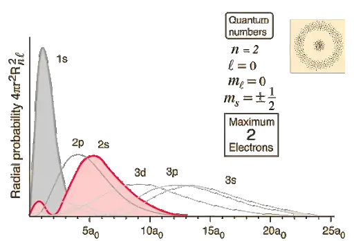

The answers I have read mostly point out that electrons in 2s orbital have a higher probability to be near to the nucleus than 2p....and so they experience all the charge of nucleus, and shield the 2p electrons from experiencing it.
But, as the radial probability graphs indicate, 2p electrons have a lesser average distance from the nucleus than 2s. Also, the most probable distance of 2p is lesser the most probable distance of 2s. So, mostly, 2p electrons would be nearer to nucleus. And so, shouldn't THEY (2p electrons) shield 2s electrons instead?
I am new to QM....so please give a satisfactory explanation.
