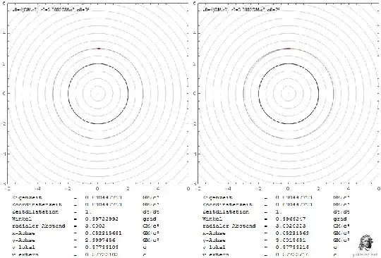

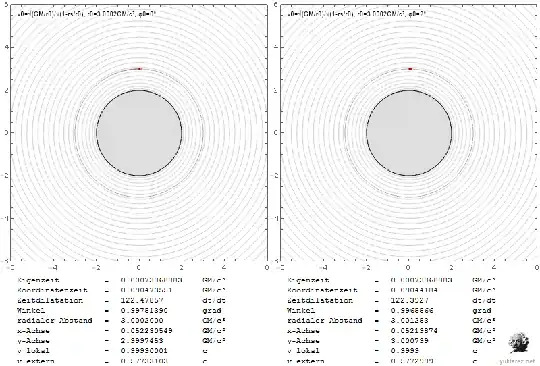

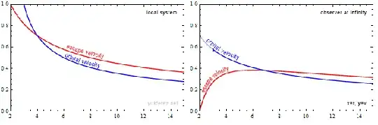

The Plots show the velocities in terms of v/c and the Schwarzschild r coordinate in units of GM/c². Left is the system of a local observer, and right like an observer at infinity would see the Shapiro-delayed velocities.
Locally the escape velocity equals the orbital velocity at r=4GM/c², while at infinity their equality is observed at r=2·(2+√2)=6.8284GM/c².
At the photon sphere a local observer would observe the orbiting particle with c, while an observer at infinity would measure it slower by a factor of √(1-2/3), so with 0.577c.

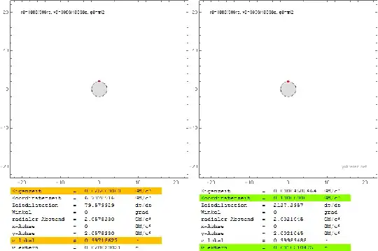

An escaping particle near the event horizon would need a local radial velocity of c, and seem to have zero velocity for the observer at infinity.
The different factors for the radial and the transversal components is due the graviational length contraction which is only in radial direction (there is more radius inside the circle than the circumference divided by 2π).
To sum it up:
Locally, the radial escape velocity for Einstein is the same as for Newton. At infinity it is observed slower than that.
Also locally, the angular orbital velocity for Einstein is higher than for Newton, but at infinity it is observed to be the same as it would be under Newton.
The escape velocity can be lower than the orbital velocity, therefore orbits near the photon sphere are unstable in a sense that if your velocity is not only transversal but splits into a transversal and a radial component you will escape to infinity. With Newton you would just get an elliptical orbit with everything else staying the same.

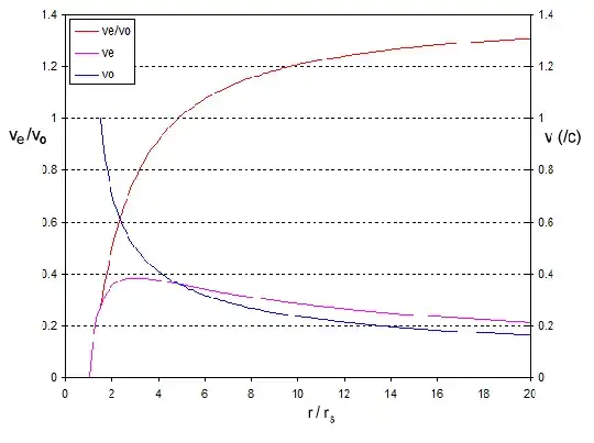

If we graph these we get:
escape velocity etc
Note that the $x$ axis is in units of $r/r_s$ i.e. $2$ means $2r_s$, $3$ means $3r_s$ and so on. The ratio $v_e/v_o$ is plotted on the left hand axis and the speeds $v_e$ and $v_o$ on the right hand axis.
At large distances the ratio $v_e/v_o$ approaches $\sqrt{2}$, which is the Newtonian value, but as we approach the black hole the ratio falls. It becomes less than one at about $r/r_s = 4.8$, and at the last possible orbit where the orbital velocity is $c$ it has fallen to about $0.27$.
This probably seems odd at first glance, but it's due the well known fact that any infalling object slows as it approaches the event horizon and in fact its velocity tends to zero at the horizon. The object would take an infinite time to reach, let along cross, the event horizon. See the question How can anything ever fall into a black hole as seen from an outside observer? for more on this.
