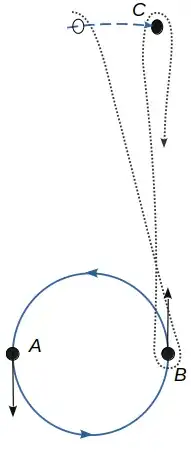

Consider the following configuration: two black holes (of comparable masses), let us denote them $A$ and $B$, are closely orbiting each other on nearly circular orbits, while the third black hole, $C$ orbits around the first two at much greater distance and thus with lower velocity (see the image):
Image, my work based on Dyson's figure
A probe starts from vicinity of $C$ towards $A$ and $B$ and after circling one of this pair flies back toward $C$, circles it performing almost perfect turnover and flies back again towards $A$ and $B$ and so forth. During each time the trajectory passes near the component of pair $A$ and $B$ that has instantaneous velocity component directed toward $C$. As a result of each flyby near $A$ or $B$ the probe gathers speed. If all velocities remain nonrelativistic, the speed gain is approximately double the instantaneous velocity component of either $A$ or $B$ toward $C$. Taking into account that usually instantaneous velocity $\mathbf{v}_A$ or $\mathbf{v}_B $ would be at some angle from direction to $C$, on average after large number $N$ of iterations the probe's velocity could be of order $v_\text{probe}\sim N u$ where $u$ is an average orbit velocity of a pair $A$ and $B$.
As probe's velocity become comparable with the speed of light, relativistic laws of velocity addition must be taken into account, so of course the probe could never go faster than the speed of light, but (in principle) could approach it after sufficiently large number of iterations. For a triple black hole system described here, similar trajectories could be constructed for photons, they would of course be always travelling at the speed of light but as a result of this gravitational assists photons would gain energy, extracting gravitational/kinetic energy from the system in, these trajectories could be seen as ultimate limit of gravitational assits.
