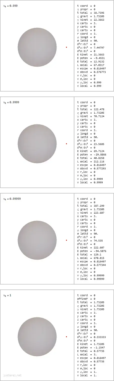

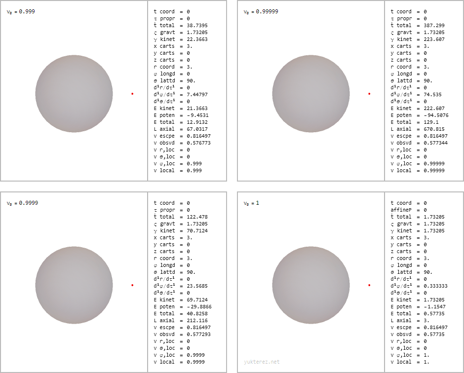

For example, if you plot an orbit around the photon sphere, the photon with v=c will make infinite revolutions, and a particle with v/c=999999... will need more 9s after the decimal point to make more revolutions:
schwarzschild photon sphere with different velocities
At the end of the simulation the particles that started with v<c also show v=c in the numeric display when they approach r=rₛ, but that is just a rounding artifact since there's only so much space for the 9s after the decimal point.
