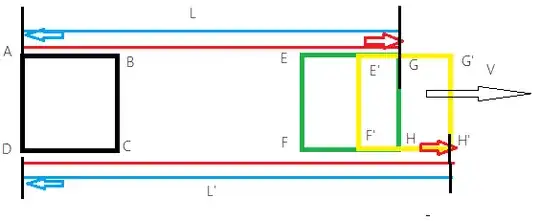

One way speed of light measurement could be reduced to synchronizing distant clocks. Let's use Einstein's boxcar experiment with slight modification: Initially let's have a stationary boxcar and mark exactly points A, A', B, B'where A and B are on the embankment and A'and B' attached to the boxcar. at point A let's install a laser pointing directly to a mirror at A'(attached to the boxcar) which is reflecting the laser beam back to a photo sensor at A.Let's make the same arrangement at B and B'.If we move boxcar with non-relativistic speed (uniform )v from A to B (or from B to A) the mirrors at A'and B' will reflect the light at exactly the same moment, so we can synchronize the clocks at A and B. Accuracy of such synchronization would depend how precise A, A'and B and B' are marked, how big is the distance between A and B and how fast the boxcar is moving.
