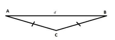

SETUP: Let’s say there are two points A and B and we want to measure the speed of light from A to B and the distance between A and B is d. So we station our apparatus which can send a light signal on A and another one, which can receive a light signal on B. A and B is equipped with identical apparatus which can shoot a ball at the same speed. There is another point C which is equidistant from both A and B. C is equipped to measure the time interval between the consecutive arrival of balls from A and B.
Note: There are no clocks on either A or B. The points A, B and C are in rest with respect to each other.
Now, A shoots ball-A towards C and simultaneously sends a light signal to B, and the moment B receives the light signal from A, B shoots ball-B towards C. Now both balls ball-A and ball-B head towards C and reach C. The time difference ?t, between the arrival of ball-A and ball-B is expected to be same as the time taken for light to travel from A to B.
$$c_{AB} = \frac{d}{\Delta t}$$
There are no relativistic effects involved as the balls are traveling at relatively small speed than light. And A, B and C are all at rest with respect to each other. By using balls, to signal to a third point C, instead of B using light to try to communicate back with A, this experimental setup solves the need to synchronize clocks between A and B and also avoids the circular trip of light.

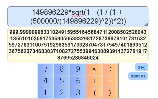

Now note that A and B are in rest with respect to each other. They both are designed to use 500,000 Joules to accelerate the balls. The energy is same for both A and B as they are in rest with respect to each other. Newtonian speed of 1000 m/s is achieved by ball_A as light travels at infinite speed in the direction of AB. Assuming the speed of light from B to A would be $c/2$ which is 149,896,229 $m/s$. So when B uses 500,000 Joules. Relativistic resultant velocity can be calculated for this using the formula
$$v=c/2\sqrt{1-\frac{1}{\left(1+\frac{K_e}{m(c/2)^2}\right)^2}}$$
So,
$$149896229\sqrt{1-\frac{1}{\left(1+\frac{500000}{(149896229)^2}\right)^2}} = 999.99999998$$
So the time ball_B takes to reach C is
$$\frac{200000000}{999.99999998} = 200000.000004$$
So the difference between the arrival of ball_A and ball_B is
$$200000.000004 - 200000 = 0.000004$$

Suppose the distance from A to C (and from B to C) is $s$. Suppose the ball from $B$ arrives at $C$ 1 second later than the ball from $A$.
Your conclusion: The ball from $B$ was fired 1 second later than the ball from $A$. Therefore light takes 1 second to get from $A$ to $B$. Therefore the rightward velocity of light is $1/s$.
My conclusion: The two balls were fired at exactly the same time (call it time zero). Therefore light takes 0 seconds to get from $A$ to $B$ and the rightward velocity of light is infinite. However, your cannons fire balls at some velocity $v$ in the rightward direction and at velocity $v'=sv/(s+v)$ in the leftward direction. This explains why the rightbound ball arrived at time $t=s/v$ and the leftbound ball arrived at time $s/v'=t+1$.
What basis do you have for asserting that one conclusion is better than the other? You seem to be saying that you will do an experiment with one cannon, measuring the speeds at which it shoots balls over short distances. But how are you going to measure those speeds without assuming that the speed of light is the same in both directions?

Step II. I do your experiment, taking the distance from $A$ to $B$ to be 2 and the distance from either to $C$ to be 1.
At time $0$, I send a light beam from $A$ to $B$ and a cannonball from $A$ to $C$. When the light beam arrives at $B$, a cannonball is sent to $C$. The difference between the two arrival times at $C$ is $$T=2/c_R+1/v_L-1/v_R$$ where $c_R$ is the rightbound speed of light.
Because you've already got values for $v_L$ and $v_R$, and because you've observed the value of $T$, you can now calculate $c_R$. This gives
$$c_R= {2\over T-2A}$$
Step III. I define "your theory" to be that $s_L=s_R=c_R=1$ (that is, the leftbound and rightbound velocities of a cannonball are equal, and likewise for light). Your theory implies that $T=2$.
I will assume that the experimental results are consistent with your theory. Therefore $T=2$ and I will plug this into the expression for $c_R$ above to get
$$c_R={1\over 1-A}$$
Step IV. Now we've done the experiment, and we've assumed that the results are consistent with your theory that $c_R=1$ (because it's possible that $A=0$). But we've discovered that then they must also be consistent with any theory in which the equation at the end of Step III holds.
As $A$ can take any value between $-1$ and $1$, $c_R$ can take any value between $1/2$ and $\infty$.
Conclusion. Your experiment reveals nothing about the one-way speed of light beyond what we already know for trivial reasons.
