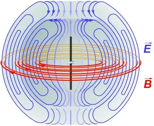

When you keep all this in mind it is actually a helpful picture but might not be enough as a visualization what is really going on. I have not looked deeply for a video but this diagram from wikipedia might help a bit:
What the author tried to visualize here is the moving EM-wave that has no E nor B component along the axis of the dipole but radiates outwards in circular symmetry.
The E-field lines at the beginning of one wave cycle start from the top of the dipole and end at the bottom of the dipole, exactly as you would have drawn the E-field of two opposite charges along the axis. Now these charges are not fixed but oscillate along the z-direction, this current creates a magnetic field perpendicular to the current direction, the red circles in the x-y-plane.
If you want to calculate the direction of the energy flux of the wave you need the poynting vector $$\vec{S} = \vec{E}\times\vec{H}$$ In this example $\vec{S}$ points radially outwards or perpendicular to the dipole axis.
Additionally you can understand with this picture how an antenna works. If you reverse the time the waves arrive at your dipole instead of being sent out. The arriving waves induce a current only if the incoming field is not propagating along the z-axis of your dipole and the best efficiency is achieved for an wave perpendicular to the axis of the dipole.
