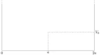

Following Kevin Zhou's proposal, I considered this system instead
For $E<V_0$, the solutions are given by \begin{align} \psi_1(x) & = \sin kx \\ \psi_2(x) & = \frac{\sin ka}{\sinh \lambda a} \sinh \lambda(2a-x), \end{align} with $k=\sqrt{2mE}/\hbar$ and $\lambda=\sqrt{2m(V_0-E)}/\hbar$. And the spectrum is found from \begin{equation} \lambda \tan ka = -k \tanh \lambda a, \end{equation} which has to be solved numerically. For $E>V_0$ we simply let $\lambda \rightarrow iq$ with $q=\sqrt{2m(E-V_0)}/\hbar$.
