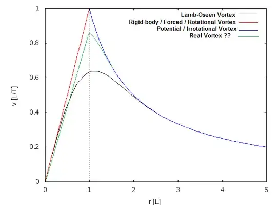

Basically Vortex has a clear construction, which can mainly be expressed mathematically very simply way. Ie Rankine Vortex An example of this construction is picture below;
If you look the German-wiki from the "Lamb-Oseen vortex" you find this picture, I modified it to show the interes of my Question (green line).
I am interested about there true shape of this peak. How the numerical model's works at this peak compared to experiments. I think here lies the problem. It's clear that most of the Vortexes aren't like "Lamb-Oseen", but I doubt if they are abslutely like the "Rankine" either. So it's something like the "Burger". When i think the current calculation power, it sound not reasonable that the problem lies just on complexity, as there is even exact solutions available.

- Energy dissipation rate predicted by the "Lamb-Oseen" is too big, compared to reality.

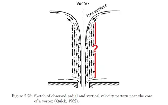

- Rankine Vortex has an extra pressure gradient in the Water, directed inwards, that prevents evolution of the rigid-body flow to the irrotational state. The counter force of this, might be an extra pressure gradient directed outwards the rigid-body, and this might be the cause to such an stable air core, as told here; How deep can a whirlpool descend?
- There is really interesting experiments made which are able to visualize this phenomenon very nice.
- I am thinking the area marked with red line &question mark in the first picture?
