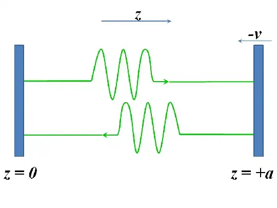

Our thought experiment is about light in a perfect optical resonator comprising two perfectly parallel mirrors with plane waves bouncing between them.
Squashing A Photon
We now "squash the light" by bringing the mirrors together: we accelerate the right hand one instantly to $v$ metres per second moving towards the other, which is kept still. Some time later, we stop the crush, again decelerating from $v$ metres per second to rest instantaneously.

and imagine a second, still reflector at $z = 0$ so as to consider a one-dimensional cavity resonator as shown in the drawing. The cavity resonator is "shrinking" and the light within it is being "squashed". Boundary conditions very like those in Eq.(1) hold, thus implying the "loop condition":
$$f\left(\frac{c-v}{c+v}\, u + \frac{2}{c+v}\, a\right) = \frac{c+v}{c-v}\,f\left(u\right)\quad\quad\quad\quad(6)$$
and the field's intensity and frequency both grow exponentially together i.e. vary like $\left(\frac{c+v}{c-v}\right)^n$with the cavity circulation number $n$.
