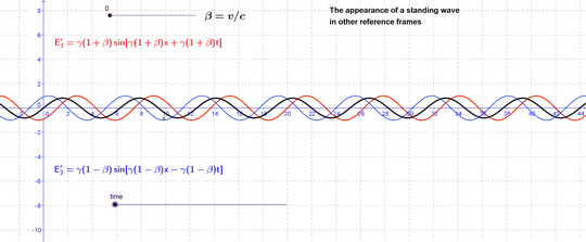

I have constructed a Geogebra applet that visualises this. I can only show snapshots here - the html5 applet is animated (though it's a bit clunky on my browser and you may want to download it, or click the show as java applet option at the bottom).
Below I show two snapshots. The first for an observer with $\beta=0$ i.e. the rest frame. The black line shows the resultant standing wave. Then an observer with $\beta=0.7$ sees the bottom picture (again, remember this is a snapshot in time). Notice how the resultant is now nearly coincident with the blueshifted (red) travelling wave.
Rest frame
Frame with beta=0.7
