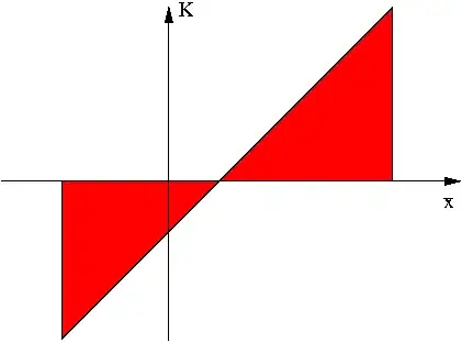

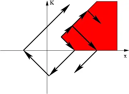

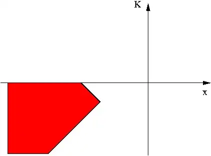

Let us define a signed kinetic energy
$$K~:=~\frac{mv|v|}{2}~=~\frac{v|v|}{2}~=~T ~{\rm sgn}(v), \qquad \qquad T~:=~\frac{mv^2}{2}~=~\frac{v^2}{2}~=~|K| . $$
It is convenient to consider a $(x,K)$ coordinate system. One may view it as a configuration space (or phase space) of the system, because the map $v \leftrightarrow K$ is a bijection: $\mathbb{R}\to\mathbb{R}$. In particular, one may plot the trajectories of the cat and the mouse in a $(x,K)$ diagram. From the work energy theorem, the slope of the trajectory is (up to a sign) the acceleration
$$ a~=~ma~=~\frac{dT}{dx}~=~ \frac{dK}{dx} {\rm sgn}(v) .$$
Thus the cat in initial state $(x_0,K_0)$ must proceed within a cone $C(x_0,K_0)$ as indicated in red in Figures 1, 2 and 3. The cat can exit the cone $C(x_0,K_0)$ through the $x$-axis $K=0$ only, and turn around, in order to reach a final state $(x,K)$ outside the cone.
$\uparrow$ Figure 1. Case $K_0>0$. The red region denotes the cone $C(x_0,K_0)$. The black oriented paths indicate optimal strategies for the cat to reach 3 different final states $(x,K)$.

$\uparrow$ Figure 3. The cone $C(x_0,K_0)$ marked with red in the case $K_0<0$.
In mathematical detail, the cone $C(x_0,K_0)$ is
$$ C(x_0,K_0)~:=~\left\{ \begin{array}{lcc} C_{+}(x_0,K_0)&{\rm for}& K_0>0, \cr\cr C_{+}(x_0,K_0)\cup C_{-}(x_0,K_0)&{\rm for}& K_0=0,\cr\cr C_{-}(x_0,K_0)&{\rm for}& K_0<0, \end{array} \right. $$
where we have defined the positive and negative cones as
$$ C_{\pm}(x_0,K_0)~:=~ \left\{(x,K)\in\mathbb{R}^2 \mid \pm a_0 (x-x_0) \geq |K-K_0| \wedge \pm K\geq 0\right\} .$$
For the cat to go from state $(x_0,K_0)$ to state $(x,K)$, there is an optimal strategy that leads to minimal time consumption $\tau(x,K;x_0,K_0)$, which we have tried to indicate in Figure 1. Roughly speaking, the cat should choose a route as far away from the $x$-axis $K=0$ as possible, as it is most costly in terms of time to have small speed. If the final state $(x,K) \in C(x_0,K_0)$ is in the cone, then two legs are needed (one maximal acceleration and one maximal de-acceleration). It is straightforward to calculate that the minimal time consumption $\tau(x,K;x_0,K_0)$ for $(x,K) \in C(x_0,K_0)$ is
$$ \tau(x,K;x_0,K_0) ~=~ \frac{2\sqrt{|K|+|K_0|+a_0|x-x_0|} -\sqrt{2|K|}-\sqrt{2|K_0|}}{a_0} .$$
There are similar expressions for $\tau(x,K;x_0,K_0)$ in various cases where $(x,K) \notin C(x_0,K_0)$ but with more legs/terms, which we will leave as an exercise to determine.
