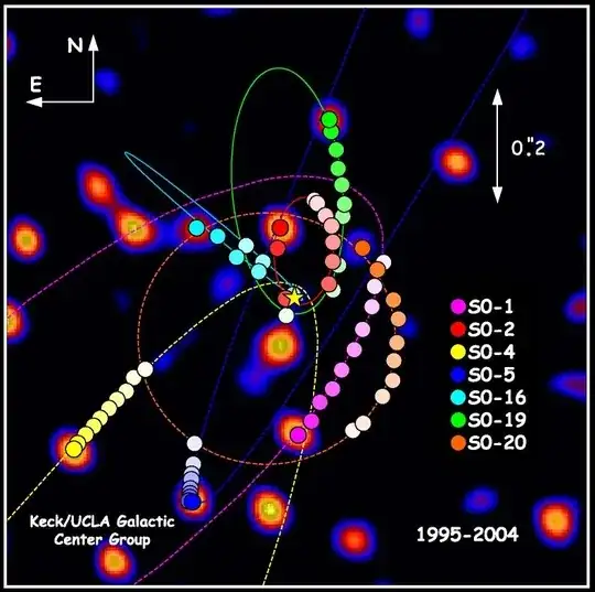

Note that we do have evidence of black holes. The image below is a map of the orbits of some of the 28 stars tracked over a period of 16 years at the interior of our galaxy. The orbits are less than 100 AU (about the orbit of Pluto) and are zipping along around 1000 km/s (compared to Pluto's 4 km/s).
(source)
We know that the orbital velocity of an object is related to the attractor mass; since these 28 stars are all orbiting the same point, the attractor is pretty much the dead-center of the galaxy (indeed it is stationary to ~1 km/s). A 2009 study, Gillessen et al (ApJ 692), has shown that the stars require the interior object's mass to be about 4 million solar masses, $\sim8\times10^{39}\,\rm g$ . Observations of Sgr A* itself suggest its radius is less than 1 AU. Such a massive object in such a small space is beyond any reasonable doubt, a supermassive black hole.
