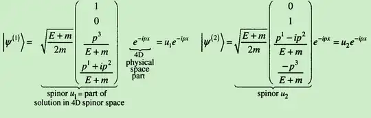

We can get the spin of an electron from Dirac equation. The reasons for electrons to have two spin polarizations are due to: The dimension of the physical space time is 4 Why don't we construct a spin 1/4 spinor?. Therefore, if we want to construct a spin space, we need at least four basis vectors. For fermions, we can use two complex bases vectors to construct a spinor (hence two spin polarization states). This is because, these two could provide four independent variables since complex. This can be easily seen from below:
The word spin comes from the fact that when we try to make a link or map between the spin space and the real physical space, we need, locally, the Lie algrebra, which is responsible for the spinning behaviour: SU(2)~SO(3) locally.
