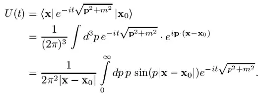

Taking from Peskin & Schroeder p.14:
Propagation amplitude
They then calculate it asymptotically, and refer to: Gradshteyn and Ryzhik (1980), #3.914 for an exact solution
Searching that reference, we come across: #3.914, 6: (Available here)
Calculation
Where $K_2$ is the modified Bessel function.
