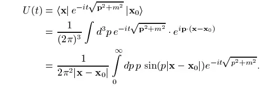

  1. Technical question: How do I get from the second to the final step? enter image description here

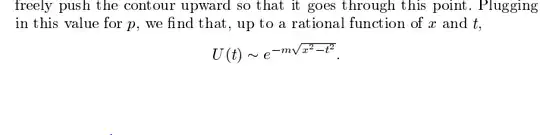

  2. The phase is stationary when $p = \frac{imx}{\sqrt{x^2 - t^2}}$, but that does not lead me to the same conclusion as P&S in a straightforward way. Am I missing some further approximations? enter image description here

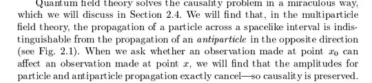

  3. Here P&S talks about causality in terms of measurements outside the light cone affecting the inside. They say that QFT will take care of it by introducing antiparticles, which will cancel out the contribution from the particle. But didn't we just argue that, for real particles at least, the amplitude does not cancel? (since their antiparticle are themselves) So what happens to the causality, or are there no real particles? I am confused. enter image description here
