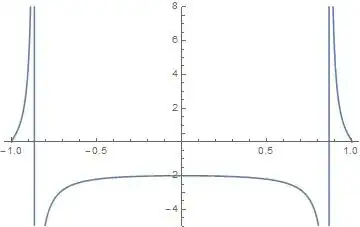

I would like to understand the thermodynamic properties of this black hole solution. The temperature is given by $$ T=\frac{r_+-r_-}{4\pi r_+^2}=\frac{1}{2\pi M}\frac{\sqrt{1-q^2}}{(1+\sqrt{1-q^2})^2}$$ I calculated the heat capacity $$ C:=T\bigg(\frac{\partial S}{\partial T}\bigg)_Q$$ by using $S=\pi r_+^2$ and a bunch of applications of the chain rule one obtains $$ C=2\pi M^2\frac{\sqrt{1-q^2}(1+\sqrt{1-q^2})^2}{1-2\sqrt{1-q^2}}$$ which has some curious behavior that I would like to understand physically. I've plotted $\frac{C}{2\pi M^2}$ as a function of $q$, and the result is shown below.
$\hspace{4cm}$$C$ as a function of $q$
For small $q$, the heat capacity is negative (this is the expected behavior, just like in Schwarzschild), and as one adds charge, the heat capacity steadily decreases. However, as one can easily see, the denominator has zeros at $|q|=\frac{\sqrt 3}{2}$, and therefore the heat capacity diverges (!) to $-\infty$ at these values, "emerging from $+\infty$" for larger values of $ | q |$. In, once again, strictly decreasing fashion. What I would like to understand is:

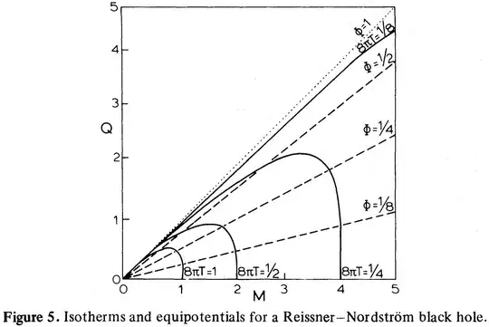

While $C_\Phi$ is finite and negative everywhere, $C_Q$ has an infinite discontinuity at $Q/M =\frac{1}{2}\sqrt{3}\approx 0.87$. At this point its sign changes too: $C_Q$ is positive for more highly charged black holes. This remarkable behaviour of $C_Q$ occurs because the $Q, T$ coordinates are double valued, which is illustrated in Fig. 5 [reproduced below]. The $Q, \Phi$ coordinates, however, form a non-degenerate coordinate system everywhere. The physical reason for the double valued $M (Q, T)$ is that the temperature of a black hole tends to zero not only in the limit $M\to\infty$, but also in the lower limit $M \downarrow Q$ if $Q$ is kept constant, since in both cases the surface gravity vanishes.

In the above-mentioned appendix 1 we find a demonstration that only those functions that explicitly depend on the (supposedly) degenerate coordinates $Q,T$ are affected by the divergence of $C_Q$. This is done by simply calculating a number of thermodynamic functions and showing that they have no singular behavior, unless they depend on the $Q,T$ coordinates.
