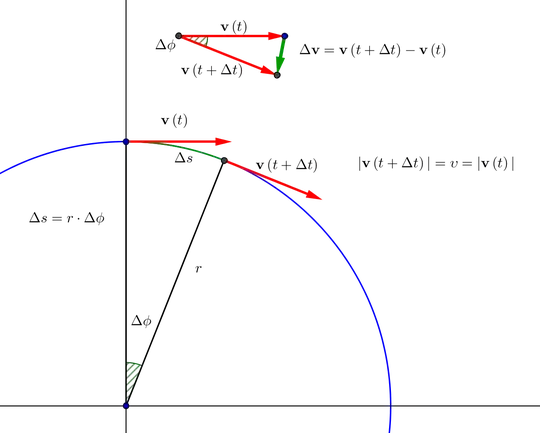

Imagine an object steadily traversing a circle of radius $r$ centered on the origin. Its position can be represented by a vector of constant length that changes angle. The total distance covered in one cycle is $2\pi r$. This is also the accumulated amount by which the position has changed...
Now consider the velocity vector of this object: it can also be represented by a vector of constant length that steadily changes direction. This vector has magnitude $v$, so the accumulated change in velocity is $2 \pi v$.
The magnitude of acceleration is then $\frac{\text{change in velocity}}{\text{elapsed time}}$, which we can write as: $$a = \frac{2 \pi v}{\left(\frac{2\pi r}{v} \right)} = \frac{v^2}{r} \,.$$
Q.E.D.

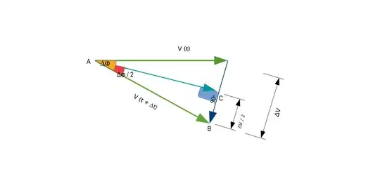

Pic 2
In right-angled-triangle ABC \begin{equation} \dfrac{|\dfrac{\Delta \mathbf{\vec v}}{2}|}{|\vec V|}=Sin\dfrac{\Delta \vec \theta}{2} \tag{01} \end{equation} If \begin{equation} \theta \tag{02} \end{equation} is small \begin{equation} v(t) \approx v(t + \delta t ) = \mathbf{\vec v} \tag{03} \end{equation} \begin{equation} \dfrac{|\dfrac{\delta \mathbf{\vec v}}{2}|}{|\vec V|}=Sin\dfrac{\delta \vec \theta}{2} \tag{03} \end{equation} For small angle \begin{equation} \delta \theta \approx Sin {\delta \theta} \tag{04} \end{equation} So on rearranging \begin{equation} \dfrac{\delta \mathbf{\vec v}}{2} =\dfrac{\delta \vec \theta}{2} \times \vec v \tag{05} \end{equation} \begin{equation} \delta \mathbf{\vec v} =\delta \vec \theta \times \vec v \tag{06} \end{equation} \begin{equation} \dfrac{\delta \mathbf{\vec v}}{\delta \mathbf{t}} =\dfrac{\delta \vec \theta}{\delta \mathbf{t}} \times \vec v \tag{07} \end{equation}
\begin{equation} \mathbf{\vec a}=\dfrac{\delta \mathbf{\vec v}}{\delta \mathbf{t}} \tag{08} \end{equation}
\begin{equation} \vec \omega =\dfrac{\delta \vec \theta}{\delta \mathbf{t}} \tag{09} \end{equation}
\begin{equation} \mathbf{\vec a}=\vec \omega \times \vec v \tag{10} \end{equation}
\begin{equation} \mathbf{a}=\omega \times v \tag{11} \end{equation} And since \begin{equation} \mathbf{v}=\omega \times r \tag{12} \end{equation} So \begin{equation} \mathbf{a}=\dfrac {v^{2}}{\mathbf{r}} \tag{13} \end{equation}

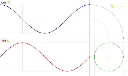

The position of a particle moving along a circular path can be described by two half-out-of-phase sine waves -- or equivalently, a sine wave and a cosine wave:
An animated illustration of the relationship between rotation and the sine function, as parameterized by time.
(via)
This is easy to derive: suppose the particle is moving at a constant angular velocity $\omega$ around a circle of radius $r$. Then $\theta = \omega t$, and basic trigonometry tells us that the position of the particle given $\theta$ is given by $x = r \cos \theta$ and $y = r \sin \theta$. We can substitute to get $x = r \cos (\omega t)$ and $y = r \sin (\omega t)$.

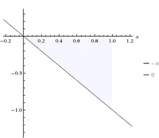

The formula for kinetic energy is $E = \frac{1}{2} mv^2$ -- that's basic Newtonian mechanics. What's the formula for $P$ in this case? This is the hardest part of the derivation. The potential energy stored in the spring is equal to the amount of negative work done to stretch it to $x = r$. So we have to remember the formula for work: $W = Fd$, where $d$ stands for distance traveled -- i.e. $x$, assuming that we start at $x = 0$. But then we have a problem. $F = -kx$ is not constant -- it's a function of $x$.
In general, this would mean we have to do calculus. But luckily enough, $F = -kx$ is a linear function, and so the value we want is equal to the area of the triangle formed by the $x$ axis and the line $F = -kx$:
The integral of -kxdx from x = 0 to x = 1, with k = 1.
(via)
In the above chart, $k = 1$, the distance traveled $d = x_\text{max} = 1$, and the area of the given triangle represents the value you get when you multiply $F(x)$ by distance traveled, adjusting for changes in the value of $F$ as the distance increases. But since the height of the triangle is $-kx_\text{max}$ and the base of the triangle is $x_\text{max}$, we can just use plain old geometry. The area of a triangle is $\rm \frac{1}{2} base \times height$ -- or, here, because $x_\text{max} = r$
$$W = -\frac{1}{2} kr^2$$

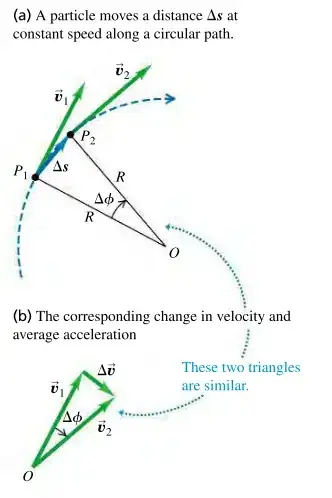

$$\vec{a}_{avg}=\frac{∆\vec{v}}{∆t}$$ So, $$ a_{avg}=\frac{|∆\vec{v}|}{∆t}$$ From (a) and (b) in the figure, it is clear that the velocities triangle is similar to the triangle $OP_{1}P_{2}$ So $$\frac{|∆\vec{v}|}{v_{1}}=\frac{|∆\vec{s}|}{R}$$ $$\frac{a_{avg}∆t}{v_{1}}=|∆\vec{s}|/R$$ then $$ a_{avg}=\frac{|∆\vec{s}|v_{1}}{R∆t}$$ However, as t goes to zero, we have $|∆\vec{s}|=∆s$ and $\frac{∆s}{∆t}=v_{1}$. Therefore, $$ a=\frac{v_{1}^{2}}{R}$$ However, since speed is constant we can simply drop the subscript 1 to get
$$ a=\frac{v^{2}}{R}$$
