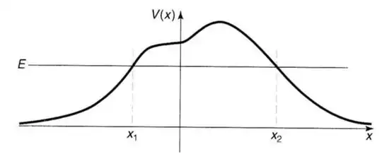

Suppose we have quantum mechanical plane waves of energy $E$ incident upon a one-dimensional potential barrier $V(x)$ with sloping sides.
One can compare the WKB solutions in the three relevant regions to asymptotics of the Airy function solutions to the linearized Schrödinger equation near the turning points to obtain matching formulae, relating $A, B$ (the coefficients of the right- and left-propagating waves, respectively, left of the barrier) to $F, G$ (the coefficients of the right- and left-propagating waves, respectively, right of the barrier). One can then construct the relevant scattering matrix $S$, defined by:

$$\gamma=\frac{1}{\hbar}\int_{x_{1}}^{x_{2}}\sqrt{2m\left[V\left(x\right)-E\right]}dx$$
measures the "strength" of the reflecting, classically-forbidden region.
