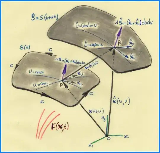

Helmholtz Transport Theorem and Faraday's Law
Let $\:\mathbf{F}\left(\mathbf{x},t\right)\:$ be a time-varying vector field defined at points $\:\mathbf{x}=\left( x_{1},x_{2},x_{3}\right)\:$ of a region of $\:\mathbb{R}^{3}\:$ and time $\:t$. If $\:S(t)\:$ is a surface in motion-deformation described by the velocity field $\:\mathbf{w}\left(\mathbf{x},t\right)\:$ of its points, as in Figure, then for the rate of change of the flux of $\:\mathbf{F}\:$ through this surface we have
\begin{equation} \dfrac{\mathrm d}{\mathrm dt}\int\limits_{S(t)}\mathbf{F}\left(\mathbf{x},t\right)\boldsymbol{\cdot} \mathrm d\mathbf{S}=\\ \int\limits_{S(t)} \left[\dfrac{\partial \mathbf{F}}{\partial t} + \left(\nabla \boldsymbol{\cdot} \mathbf{w}\right)\mathbf{F} + \left(\mathbf{w}\boldsymbol{\cdot}\boldsymbol{\nabla}\right)\mathbf{F} - \left(\mathbf{F}\boldsymbol{\cdot} \boldsymbol{\nabla}\right)\mathbf{w}\right] \boldsymbol{\cdot} \mathrm d\mathbf{S} \tag{A-01a} \end{equation}
or from this equivalently \begin{equation} \bbox[#E6E6E6,8px]{\dfrac{\mathrm d}{\mathrm dt}\int\limits_{S(t)}\mathbf{F}\left(\mathbf{x},t\right)\boldsymbol{\cdot} \mathrm d\mathbf{S}\:=\:\int\limits_{S(t)} \left[\dfrac{\partial \mathbf{F}}{\partial t} + \left(\nabla \boldsymbol{\cdot} \mathbf{F}\right)\mathbf{w} - \boldsymbol{\nabla} \boldsymbol{\times} \left( \mathbf{w} \boldsymbol{\times} \mathbf{F}\right)\right]\boldsymbol{\cdot} \mathrm d\mathbf{S}} \tag{A-01b} \end{equation} Equation (A-01a) or (A-01b) is known as the Helmholtz transport theorem.
['Generalized Vector and Dyadic Analysis', Chen-To Tai, IEEE PRESS, 2nd Edition 1997 equations (6.11),(6.12) page 119.]
Equation (A-01b) is important for the expression and understanding of Faraday's Law in electromagnetics \begin{equation} \mathrm{emf} \: = \: - \: \dfrac{\mathrm d\Phi}{\mathrm dt} \tag{A-02} \end{equation} that is, the electromotive force $\:(\mathrm{emf})\:$ along a closed path $\:C \:$ equals to the opposite of the time rate of change of the magnetic flux $\:\Phi \:$ passing through any surface $\:S\:$ whose perimeter is the closed path. Note that the surface need not be necessarily stationary but can be in motion and/or under deformation. Now, the magnetic flux $\:\Phi \:$ passing through a surface $\:S\:$ is defined as \begin{equation} \Phi\: \equiv \: \int\limits_{S}\mathbf{B}\left(\mathbf{x},t\right)\boldsymbol{\cdot}\mathrm d\mathbf{S} \tag{A-03} \end{equation} where $\:\mathbf{B}\left(\mathbf{x},t\right)\:$ the magnetic-flux density vector. Replacing $\:\mathbf{F}\:$ by $\:\mathbf{B}\:$ in equation (A-01b) yields \begin{equation} \dfrac{\mathrm d}{\mathrm dt}\int\limits_{S}\mathbf{B}\boldsymbol{\cdot} \mathrm d\mathbf{S}=\int\limits_{S} \left[\dfrac{\partial \mathbf{B}}{\partial t} + \left(\nabla \boldsymbol{\cdot} \mathbf{B}\right)\mathbf{w} - \boldsymbol{\nabla} \boldsymbol{\times} \left( \mathbf{w} \boldsymbol{\times} \mathbf{B}\right)\right] \boldsymbol{\cdot} \mathrm d\mathbf{S} \tag{A-04} \end{equation} and using Maxwell's equations in empty space \begin{align} \boldsymbol{\nabla} \boldsymbol{\times} \mathbf{E} & \:=\:-\:\dfrac{\partial \mathbf{B}}{\partial t} \tag{A-05.1}\\ \nabla \boldsymbol{\cdot}\mathbf{B} & \:=\: 0 \tag{A-05.2} \end{align}
