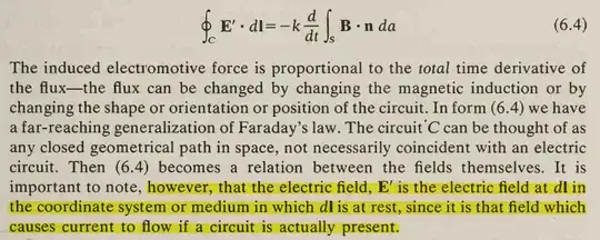

I have had this issue with Jackson's derivation of Faraday law in a moving circuit for quite some time and have not been able to resolve it. The relevant parts of the book is p. 211-212 in 2nd edition, and p. 209-211 in the 3rd ed.
Introduction:
So, let's have an open surface $S$, its normal $\vec{n}$ and its boundary $C\equiv\partial S$ as in the image:
Here, I will be using $\mathrm{d}S$, instead of $\mathrm{d}a$ and let this surface be in a magnetic field $\vec{B}$. And let this surface be moving with some constant velocity $\vec{v}$ with respect to a laboratory system.
The first claim of Jackson is the general statement of the Faraday law in the form:
$$ \mathcal{E} = -k\frac{\mathrm{d}F}{\mathrm{d}t}\tag{1}\,, $$ where: $F = \int_S \vec{B}\cdot\vec{n}\;\mathrm{d}S\,,$ and $\mathcal{E} = \oint_C \vec{E}'\cdot\mathrm{d}\vec{l}$.
Later in the text, Jackson states:
The electric field $\vec{E}'$ is the electric field at $\mathrm{d}\vec{l}$ in the coordinate system or medium in which $\mathrm{d}\vec{l}$ is at rest, since it is that field which causes current to flow if a circuit is actually present.
Then, however, he expands the derivative of the flux as:
$$ \frac{\mathrm{d}}{\mathrm{d}t}\int_S\vec{B}\cdot\vec{n}\;\mathrm{d}S = \int_S\frac{\partial \vec{B}}{\partial t} \cdot\vec{n}\;\mathrm{d}S + \oint_C (\vec{B}\times\vec{v})\cdot\mathrm{d}\vec{l}\tag{2}\,, $$

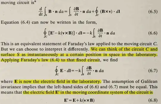

and claims that he can recast (1) as: $$ \oint_C [\vec{E}' -k (\vec{B}\times\vec{v})]\cdot\mathrm{d}\vec{l} = -k\int_S\frac{\partial \vec{B}}{\partial t} \cdot\vec{n}\;\mathrm{d}S\tag{3}\,. $$
And then he claims that if we think of the surface as instantaneously at certain position in space in the laboratory system, we can also write the Faraday law for the same circuit as:
$$ \oint_C \vec{E}\cdot\mathrm{d}\vec{l} = -k\int_S\frac{\partial \vec{B}}{\partial t} \cdot\vec{n}\;\mathrm{d}S\tag{4}\,. $$

In going to Eq. (3), he made the assumption that we are in the system connected with the moving circuit CC, but then, I do not understand how he arrives at the right hand side of (2), since the velocity in that system is zero and the last term on the right hand side of (2) should not be there.
The equation (2) does not involve changing frames, all terms refer to the original lab frame. It is a mathematical theorem for any divergence-less field, and it is easy to see in the Eulerian picture (see Jackson's footnote on p.212, 2nd edition) that it is true for magnetic field in regular circumstances (motion of the loop is continuous, magnetic field finite everywhere, line integral remains defined, and so on).
There is also a more complicated way to derive it formally, like similar theorems in continuum mechanics; the flux integral for a moving surface is a function of time both because $\mathbf B$ can change, and because the loop $C$ changes. To perform the time derivative on the integrand, one must first fix the integration domain. So a change of variables of integration is made. Imagine the loop is made of matter. Then any loop point $k$ has not only a definite position $\mathbf r_k(t)$ but also definite velocity $\mathbf v_k(t)$. The position can be expressed as $\mathbf r_k(t) = \mathcal{F}_t(\mathbf r_{k,0})$, where $\mathcal{F}_t$ is a continuous function of time and initial positions $\mathbf r_{k,0}$. It takes material point position at time 0 and returns its position at time $t$.
When the flux integral is expressed using the new integration variables $\mathbf r_{k,0}$, the integration domain becomes fixed - it is the domain occupied by the loop surface at the initial time, which does not depend on time. Now, time derivative can be brought into the integrand, and $\mathcal{F}_t$ gets differentiated, together with Jacobi's determinant of the variable transformation, and this is where velocity $\mathbf v$ and cross product with $\mathbf B$ come from. In the final step, the resulting integral is re-expressed back into the original coordinates, as integral over the coordinates of the surface attached to the loop at time $t$. Also the fact that $\nabla \cdot \mathbf B = 0$ is used (as mentioned in Jackson's footnote).
