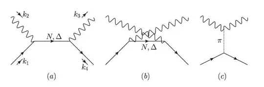

For the forces between elementary particles we have Feynman diagrams, where there exists a mediating particle for the interaction. In the simplest diagrams: for the strong it is the gluon, for the weak it is Zs and Ws and for the electromagnetic it is the photon.
Look at these diagrams some of the tree level Feynman diagrams of compton scattering , photon on a proton .
The mediator of the interaction is not a gauge boson, thus electromagnetic interactions happen even though the mediator ( the exchanged particle) is not the photon.
compton scattering
Here is Bhabha scattering, where the electron and the positron ( attractive force) are of low energy:
bhabha1bhabha2
      annihilation                                  scattering
So the question should be how can there be attractive and repulsive forces. To really answer one would have to do the mathematics that the Feynman diagrams dictate and the result will tell us the the force is attractive.
