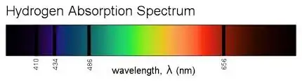

Consider the atomic spectrum (absorption) of hydrogen.
The Bohr's model postulates that there are only certain fixed orbits allowed in the atom. An atom will only be excited to a higher orbit, if it is supplied with light that precisely matches the difference in energies between the two orbits.
But how precise does 'precisely' mean. Of course, if we need energy $E$ to excite the electron to a higher energy level, and I supply a photon with just $E/2$ I would expect nothing to happen (since the electron cannot occupy an orbit between the allowed ones). But what if I supplied a photon with energy $0.99E$, or $1.0001E$ or some such number. What will happen then?
I think that the electron should still undergo excitation precisely because the lines we observe in the line spectrum have some thickness. Which means that for a given transition, the atom absorbs frequencies in a certain range.
Is my reasoning correct? If not, why? How does Bohr's model explain this? How about modern theory?
If I'm right, what is the range of values that an atom can 'accept' for a given transition?

According to Bohr model, the absorption and emission lines should be infinitely narrow, because there is only one discrete value for the energy.
There are few mechanism on broadening the line width - natural line width, Lorentz pressure broadening, Doppler broadening, Stark and Zeeman broadening etc.
Only the first one isn't described in Bohr theory - it's clearly a quantum effect, this is a direct consequence of the time-energy uncertainty principle:
$$\Delta E\Delta t \ge \frac{\hbar}{2}$$
where the $\Delta E$ is the energy difference, and $\Delta t$ is the decay time of this state.
Most excited states have lifetimes of $10^{-8}-10^{-10}\mathrm{s}$, so the uncertainty in the energy sligthly broadens the spectral line for an order about $10^{-4}Å$.

The answer is yes, the atom does absorb radiation that does not exactly match the transistion frequency. This is due to the Doppler effect that everyone knows from an ambulance with siren driving by. The frequency you hear is higher if the ambulance moves towards you and lower if it drives away from you.
It's the same with the atom. If the atom moves (and it does unless you cool it down to really low temperatures) the observed frequency of the radiation you shine in is shifted depending on the direction of travel of the light and the direction and velocity the atom moves (on the scalar product of both). The phenomen you described is called Doppler broadening of spectral lines and I would say the effect can be described using Bohr's model, since it is a purely classical effect.
The technique to get rid of these broadend lines is called Doppler free spectroscopy. It makes use of some cool techniques you can easily google.
Edit: There are more effects of broadening (like those m0nhawk mentioned in his answer). But under normal conditions the doppler broadening has the biggest effect of all those and overlays the others.
Edit 2: Wolfram alpha offers a tool to calculate the thermal doppler broadening. It says that the line in the picture above ($486\mathrm{nm}$) at $T=300\mathrm{K}$ is broadend $\Delta\lambda\approx 4\cdot10^{-2}Å$
