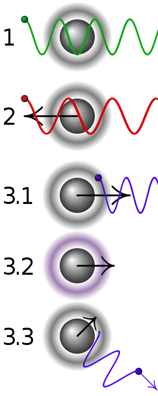

Indeed, this is how laser cooling/Doppler cooling works - with a correction that the momentum is transferred not specifically to electron, but to the atom as a whole (this is easily forgotten in discussion of electron transitions, which are usually analyzed in the center-of-mass reference frame, although good QM texts usually spell this step.)
Thus, an atom moving towards a laser absorbs higher frequency, but then re-emits the absorbed light (on average) at the frequency corresponding to the peak in its spectral line, thus losing some momentum. Likewise an atom moving away from the laser absorbs lower frequency and has its (negative) momentum increased.
Simplified principle of Doppler laser cooling:
1 A stationary atom sees the laser neither red- nor blue-shifted and does not absorb the photon.
2 An atom moving away from the laser sees it red-shifted and does not absorb the photon.
3.1 An atom moving towards the laser sees it blue-shifted and absorbs the photon, slowing the atom.
3.2 The photon excites the atom, moving an electron to a higher quantum state.
3.3 The atom re-emits a photon but in a random direction. The atom momentum vectors would add to the original if they were in the same direction but they are not so the atom has lost energy and, therefore, cooled.
(source: Laser cooling)
