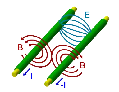

According to relativity, If magnetic field is just an electric field viewed from a different frame of reference, why is the magnetic field around the wire is circular?

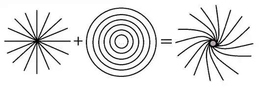

Relativity doesn't quite say this. Take a look at Minkowski's Space and Time: "In the description of the field caused by the electron itself, then it will appear that the division of the field into electric and magnetic forces is a relative one with respect to the time-axis assumed; the two forces considered together can most vividly be described by a certain analogy to the force-screw in mechanics; the analogy is, however, imperfect". Also see Jackson’s Classical Electrodynamics section 11.10 where he says "one should properly speak of the electromagnetic field Fμv rather than E or B separately". The field of the electron is the electromagnetic field, and it has a "screw" nature, which you can trace back to Maxwell. When you have two charged particles with no initial motion, you see linear electric force only. When you throw one past the other, you also see rotational magnetic force, as per positronium. IMHO the electron's electromagnetic field isn't totally unlike the frame-dragged gravitomagnetic field, and you can depict it by thinking "spinor" and combining radial electric field lines with concentric magnetic field lines, a bit like Maxwell's convergence + curl sketch on page 7 of this paper:
Why is the magnetic field around the wire circular?
Because it's rotationally symmetrical. Think of the wire as a column of electrons interleaved with a column of protons. Their electromagnetic fields cancel. But when you turn on the current and move the electrons, the fields don't quite cancel any more. The residual field has a cylindrical disposition, such that a charged particle thrown past the wire will loop around the magnetic field lines. We call it a magnetic field, but it's just one aspect of the greater whole that is the electromagnetic field.
