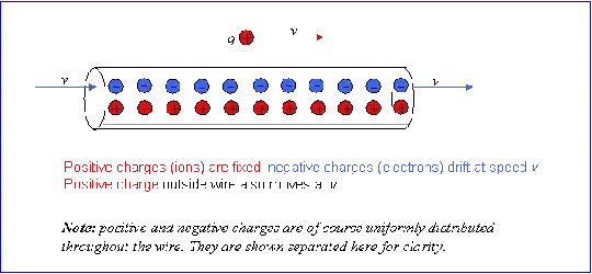

If I place a proton just as in the diagram:
then from the proton's frame of reference, the protons on the wire appear to be denser than the electrons in the wire, so it must experience an outward force. So its path should be like a parabola. Field lines are found by tracing the path followed by a test charge or test mass or whatever, placing them in a field. So in case of magnetic field lines it should be a weird field line, not circular.

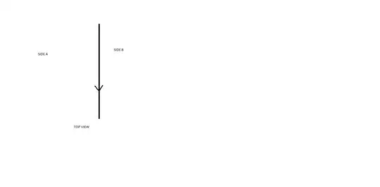

enter image description hereI have a simple argument in mind. for an infinitely long wire carrying current in the +X direction, the magnetic field at a given distance r from the wire, has 2 components(suppose) radial and tangential. Consider specifically the radial component and assume it points outwards(or inwards). Now, switch the current direction to -X. The radial component should also switch directions. But notice that this current is no different from what it was before, if you just turn the wire around(i.e) watch the wire from the other side, the situation is exactly similar to what it was before, yet the radial field direction has switched. This is an impossibility, proving that the radial field must be zero, leaving behind only circles, as the possible field shape. EDIT: CASE 1: from side A you see the current moving to the right. and the magnetic field is (suppose) radially outward. Now you reflect yourself about the wire and reach side B. You see the current moving to the left now, but the situation is essentially same(just observing from 2 sides of a wire), so the radial field is still outward. CASE 2:you return to side A, and now reverse the current(it now travels left), so the radial component must switch(inward). But havent you already seen this current? A current flowing left was encountered in CASE 1 from side B!, where you observed the radial field to be essentially outward. But now you observe it to be inward. CONTRADICTION. thus no radial field can exist.
