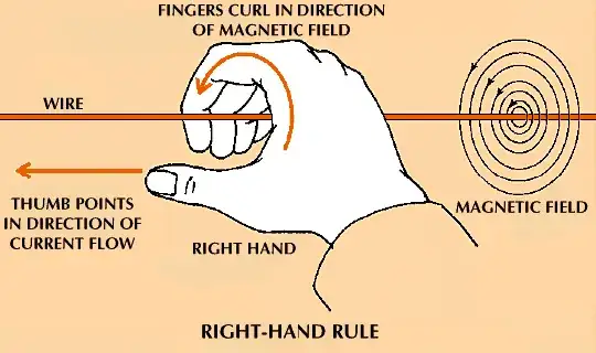

But i think that is not the direction since it should be along straight lines and not along circles(curls) and should be the direction of the force acting on the particle at a point.
Why not? The magnetic field does circulate around the wire following "circles". This is the result of the direct application of the Lorentz force law, which tells you that the force $\vec{F}$ and the field $\vec{B}$ must be perpendicular. See if this image helps:
Also, see this explanation from Hyperphysics and this related question, which might be what you're looking for.
