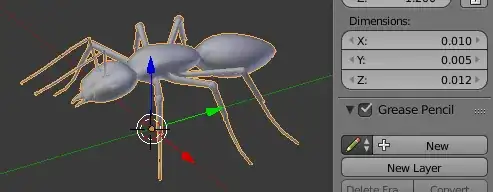

I gave the animation industry a shot and tried to measure the surface area of this free ant model. The length of the ant is now 0.005 - let's call it a meter.
This gives us a surface area of about $4.87\cdot 10^{-5}$, or $0.0000487$ square meters. So an ant that weighs 0.000025 kg with a length of 5 millimetres has a surface area of about $0.0000487 m^2$. This gives a weight/surface area rate of about $0.5335 \frac{kg}{m^2}$.
