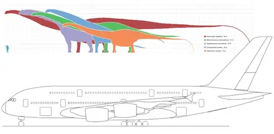

"Designing" a Big Animal Machine: Amphicoelias Fragilimus
My drawing below shows the comparative sizes of some sauropod dinosaurs, a human and one of the human's toys, the A380 Airbus. The latter (mainly from being full of air)is only a little bigger than Amphicoelias Fragilimus (the big red-brown, 60m long creature in the background) but their weights are quite comparable (at least when the airbus is unladen). The way Amphicoelias copes with the problem of heat dissipation is spoken about in Rex Kerr's answer, for she is essentially a flat beast, being very narrow when looked at from head on. Maybe her specific name fragilimus refers to this if we take the meaning of slight - I actually don't know where the name comes from. Aside from this, there is of course nothing "fragile" about such a colossal wight.
Now let's look at what Amphicoelias had evolved for. Her food was the hard needle leaves and wood of the coniferous forests of her time - hers was an era before angiosperms: before fruits, flowers and grass. So she needed to be essentially a giant enzyme-catalysed cellulose digesting plant on legs. A humble modern chemical engineer would have no trouble whatsoever in designing and having built a plant of this modest size with fairly mundane (not advanced composite) building materials; the thirty or so tonnes of cellulose in Amphicoelias's maw at a time would be a smaller figure for processing in today's economies-of-scale-obsessed world. The mechanical design and technology needed to make such a plant mobile poses problems that our technology comfortably overcomes. In short, Amphicoelias shows no sign of being up against the physical limits that would limit a giant robot.
Dinosaurs, Humans and their Airbus
