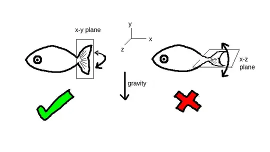

Is moving a vertical fin side to side more efficient than moving a horizontal fin up and down in water for fish locomotion? The answer might lie in how fish propel themselves using vortices, but I don't know the details.
Context: I wondered why most fish evolved to wiggle their tails side to side instead of up and down. If the ocean is an isotropic environment, I wouldn't expect any preference for any particular direction.
Could there be a physical reason?

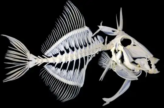

It’s to do with their skeletal structure. Most fish have a vertical bone structure, they wag their tails horizontally. fish skeleton
When I say "vertical" I mean that the bones radiate from the spine vertically, up and down, this means that the natural movement of the spine is constrained in this direction and any flexing of the spine is going to be horizontally, left and right.
Flat fish and mammals have a horizontal skeletal structure - they wag their tails up and down.
Flat fish evolved from fish with a vertical bone structure. If you look at their eyes, one of which migrated from the other side of its body, they are not symmetric. Flat fish live on the sea floor, so their horizontal structure makes sense.
SO the real question is why do fish have a vertical bone structure and land based animals, which evolved from them, do not.
That's a question for biology.
