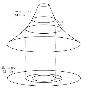

However there is a sense in which radial distances are stretched not contracted (as rockandAir8747 says in their answer). But to understand what this means you need to understand what we mean by the Schwarzschild radial distance. The Schwarzschild coordinates use a radial coordinate $r$ that we naively interpret as the distance from the centre of the black hole. However we cannot measure the distance to the centre of the black hole because there's an event horizon in the way. So what we do is lay out our measuring tape in a circle centred on the black hole and measure the circumference of this circle. Because we know that in flat space the circumference is $2\pi r$ we can take our measured circumference and divide by $2\pi$ to get the Schwarzschild radial distance $r$.
But this $r$ coordinate is calculated assuming space is flat, so it shouldn't be any surprise that it is different from the distance you'd measure if you let down a measuring tape towards the event horizon. There's a nice image showing this difference in the question Difference between coordinate and proper distance in Schwarzschild geometry:
Radial distance
The $dr$ in the bottom diagram is the distance in Schwarzschild coordinates while the $dr$ in the top diagram is the distance you'd measure with a ruler, and it's obviously bigger than the Schwarzschild $dr$.
I suppose in this sense you could claim that the ruler is length contracted near to the black hole, because it takes more rulers than you expect to cover the distance $dr$.
If you want the gory details, including an equation for how to calculate lengths measured towards the event horizon then see the questions:
The measured distance, s, between the two Schwarzschild radii $r_1$ and $r_2$ is given by:
$$ s = \left[ r\sqrt{1-\frac{r_s}{r}} + \frac{r_s}{2} log \left( 2r \left( \sqrt{1-\frac{r_s}{r}} + 1 \right) - r_s \right) \right]_{r_1}^{r_2} $$
