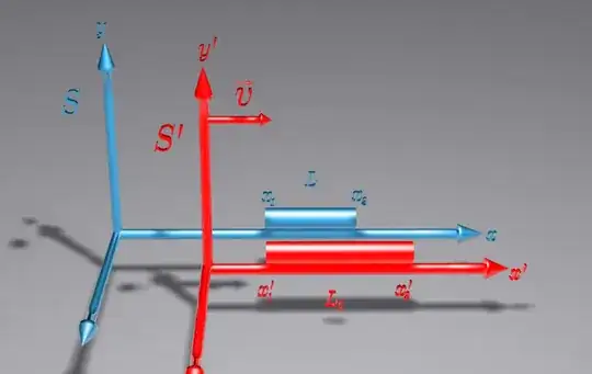

The Lorentz time dilation explains how to transform the time when it was observed in different reference systems. Let us now as space becomes. Try to understand how they relate as reference systems $S (x, y, z, t)$ and $S´ (x ', y', z ', t')$ To better understand the system assume that S is the set of Ivete, blue and S 'of Jan, red.
Using the length of a rigid rod for measurements of space. We believe that this bar is along the x axis at rest in frame S (IVETA), blue in the initial image. At rest in S, position measurements are made at the same time we can measure the length of the bar by their extreme position $x1$ and $x2$. We call this length L0 is given by:
$$L_0 = X_2 -X_1 $$
relativity!
This measure of the length of the bar resting length will call or proper length of the bar. Whenever we measure the length in the system where it is at rest length will call their own.
Similarly we can have another bar identical to the previous rigid located in the S '(Jan) along the axis x' and at rest in this system. The rod length is measured by Jan:
$$L_0 = X_2´ -X_1´ $$
and is the resting length and proper length of the bar to Jan (S ').
But what happens when Jan wants to measure the bar Ivet Ivet want to measure or bar Jan? That is, measuring the lengths of these bars seen from a moving frame. Not forget that for Ivet, Jan moves to Jan Ivet velocity v moves at speed-v.
Now we have to include the time the measurement is carried. The length of the bar seen from Jan (S ') is measured at time t' is important to note that the time is the same as that x'2 x'1. It is easy to understand, Jan takes a ruler and measure the bar by looking at the same time in the initial and final position, the difference is the length in S '. Ivet will do the same for the bar at S.
Well, how do you measure the bar Ivet Jan?. The measurement result is provided by the Lorentz transformation.
