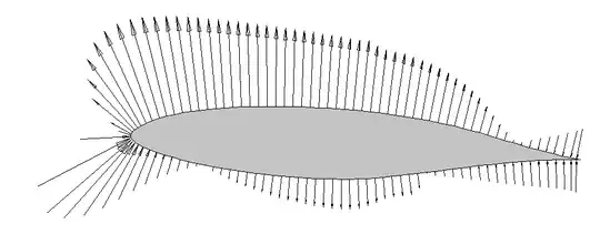

Molecules on a collision course with the wing will be decelerated ahead of the point where they would hit the wing. This point is called stagnation point because here is a very local pressure peak . Once past this point, the molecules will quickly speed up because the lower pressure downstream sucks them away from the stagnation point. If there were no viscosity, there would be a second stagnation point at the trailing edge, but in reality we find some but not a complete pressure recovery there. Below is a plot of the pressure distribution around an airfoil, courtesy of XFOIL. It offers two ways of plotting pressure distributions, one with the chord coordinate on the X axis and the negative pressure coefficient $c_p$ on the Y axis, like that: Cp plot over chord of an Eppler 502 mod
The dashed line is for inviscid flow, the solid line for pressure with viscous effects.
Another version plots the pressure as arrows orthogonally on the contour of the airfoil, like that: Same airfoil, now with arrows to indicate pressure
Please note that negative values of $c_p$ produce arrows pointing away from the airfoil, and positive values point towards the airfoil. In all cases, the formula for $c_p$ is $$c_p = \frac{p - p_{\infty}}{q_{\infty}}$$ $p$ is the local pressure, $p_{\infty}$ is the pressure far away from the airfoil, and $q_{\infty}$ is the dynamic pressure (= density times speed squared, divided by 2) far away from the airfoil. For incompressible flow at rest $c_p$ equals 1, for flow at ambient speed $c_p$ equals zero, and negative values denote suction.
