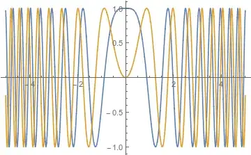

This state is, of course, not physical, as $|\Psi(x,t)|^2\equiv\text{const}$, but that's to be expected. What's surprising is that the amplitude is nonzero and constant for all space no matter how small $t$ is, but again that's to be expected, since $\delta(x)$ contains component at every momentum, no matter how high. This function looks as follows:
Mathematica graphics
Note that the higher-frequency components are increasingly further away from the origin. This is reasonable as these higher momenta travel faster.
