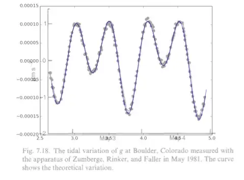

The following graph shows the result of a very impressive differential measurement of the gravitational field in Boulder, Colorado, over a period of a couple of days.
graph of g as a function of t
Floris got it from a description in a book and posted it as part of an answer to this question. Based on the caption, I'm guessing that the experiment was described in this paper by Zumberge, which I don't have access to.
There is excellent agreement between theory and experiment, and the main features of the graph are these two Fourier components:
  • period=12 hrs, peak-to-peak amplitude $\approx 1.8\times10^{-7}g$
  • period=24 hrs, peak-to-peak amplitude $\approx 1\times10^{-7}g$
In addition, there is a slower trend, which I assume comes from interference between the solar and lunar effects.

The spectacular agreement between theory and experiment shows that the diurnal experiment must be well understood theoretically. What causes it?

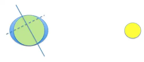

The key here is the fact that the earth's axis is at an angle relative to the plane of the sun, and that in general the moon will not be in the same plane. Thus, there are two sets of bulges - but they will be not be symmetrical with respect to the equator. What you are seeing then is the fact that a typical point on earth (away from the equator) will be closer to one bulge than the other...
In this picture you can see that for a given latitude away from the equator, you will "see" more of one bulge of the tides than the other. This asymmetry is present for both the lunar and the solar tides (although to different degree, given that the moon's orbit is tilted differently). The result is a 24 hour component.

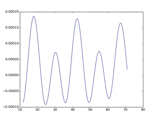

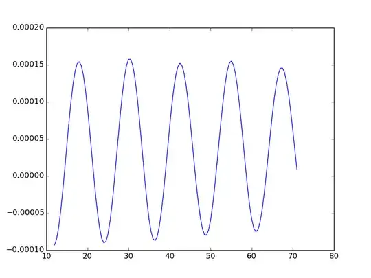

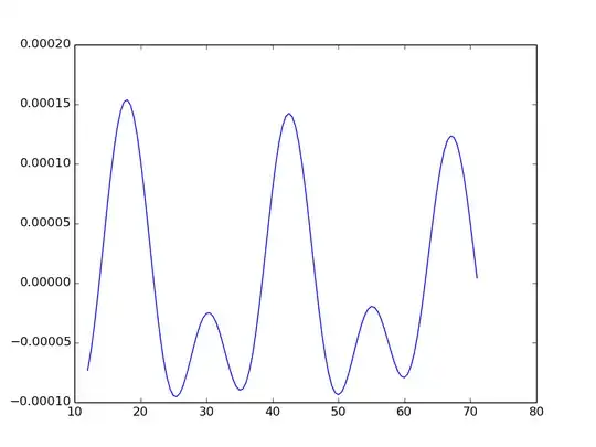

EDIT I got curious and converted the code at the link above to Python (so I could run it). Then I ran it for three different cases. The Y axis is in microgals ($1\ gal = 1\ cm/s^{2}$ - the galileo is the common unit in this field). The units on the X axis are hours - but the date is wrong (I had some trouble initially adapting the code properly - I believe these plots might correspond to January 1981, but I am not certain. The effect, however, is real.)
Latitude = 0:
Latitude = 20:
Latitude = 40:
It is pretty obvious that the asymmetry between the tides is a function of the latitude, just at my picture above would predict, and although there are clear discrepancies between this plot and the one in the original paper, the general shape and magnitude is the same - especially for latitude 40 (Boulder is at 40 degrees latitude). I think we have found the culprit.

I had some problems getting the output from my program to match the figure; but I figured it out. Here is the overlay of the data with the output of the program for May 2/3/5 1981 for latitude 40, longitude 105: enter image description here
