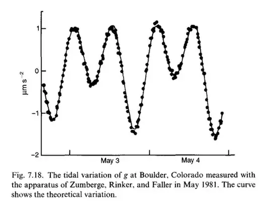

Gravitational waves were discovered 35 years ago without fanfare in 1981/2 by Zumberge, R L Rinker and J E Faller, then completely ignored.
See: "A Portable Apparatus for Absolute Measurements of the Earth's Gravity", M A Zumberge, R L Rinker and J E Faller, Metrologia, Volume 18, Number 3, http://iopscience.iop.org/article/10.1088/0026-1394/18/3/006/meta
The variation in g over the course of a day due to the sun and moon was carefully measured from the Earth's surface in 1981 as shown below.
Strain measurements taken in 1981 of local planetary effects (sun, moon) on earth's gravitation clearly showing a gravitational wave.
This is the SAME gravitational wave effect measured by the LIGO researches recently (reported 11Feb2016).
LIGO actually detects, then filters out, this local gravitational wave in order to detect the remote ones producing the ultra weak gravitational waves from binary black holes. Although the sensitivity required to detect them is 3 orders of magnitude higher in both frequency and amplitude, the LIGO "gravitational" waves are otherwise exactly the same "gravitational" waves already discovered in 1981 in our own solar system.
The proof is in the fact that LIGO detects gravitational waves but can NOT detect "tidal" gravity waves. Thus categorization of Zumberge's waves as "tidal" gravity is incorrect as tidal waves are those between two surfaces as a consequence of gravity. These cannot be detected by an interferometer. Zumberge's measurements are of gravitational variations itself, hence gravitational.
Why has the 1981 work of Zumberge, Rinker and Faller been ignored?

This represents a major misunderstanding of what a gravitational wave is. The effect presented is simply the semi-static gravitational field at earth due to the earth, moon and sun. It is predicted by Newtonian gravity. There is no 'wave' that propagated, it's the instant positions of the 3 bodies that change over 1 day (and over 1 year also).
It does not show that the change moved at the speed of light, which gravitational waves do. Nothing in Newton's equations talk about the speed of light. The GR equations for 3 bodies moving like the earth-sun-moon can only be solved approximately, and in this case it'd be through a post-Newtonian approximation. The pseudo-static term(s) would be the same but possibly some GR correction - and if it is (And I'm not sure if the strongest term correction might not be something like the term for the perihelion of mercury, or something else, in any case extremely small and not measurable in their g measurement). But that's not even a grav wave. The grav waves would be even smaller probably - you'd have to compute the rate of change of the quadrupole moment of the configuration, and do some other calculations. The simpler problem of just the grav radiation of the earth-sun rotation around each other gives a resultant power dissipated that translates in the orbit of the earth loosing altitude ('altitude' above the sun) of the size of 1 proton per day. That g change they measured in your graph is about 10 to the minus 7 g's. It isn't even dissipative, as the bodies keep doing the same thing over and over, in your approximation. If you don't see that dissipation you are not seeing the gravitational waves.
There is probably many other ways to see that what you're discussing, what the graphic measured, is not a gravitational wave, but rather a very slow change in a static gravity field, the one produced by the 3 bodies.
Grav waves produce something different than just a change in gravity in one direction, they do it in 2 directions at once, an asymmetrical squeezing of a circle first in one axis and then in the other, like squeezing a balloon in one direction, making it bulge in the other.
Like Nathaniel said, it's like comparing a (semi) static electric field (say produced by rubbing a couple rags together) and moving them around some, with light.
Note: yes, even changing static fields can not produce a change in what's observed at a distance faster than the speed of light, but that doesn't come in at all in your graphic, too small a differential effect for it to see it.

[Note: I work on gravitational waves, and am an author on several of the recent LIGO papers on GW150914 — though I am not a member of the LIGO collaboration. So if you're looking for conspiracy theories, that can be your reason to ignore me.]
Zumberge, Rinker, and Faller (ZRF) did not measure gravitational waves. To explain this, I'll start off with an analogy, then discuss gravitational waves directly, followed by the actual math from Einstein's equations that shows very explicitly what I'm talking about.
But first, I'll briefly point out the most obvious and (to me) persuasive point: ZRF found variations at about twice the frequency of the Earth's rotation — consistent with the usual tides, rather than gravitational waves. But Einstein's theory tells us that gravitational waves will only be produced strongly by the orbit of a pair of objects. The moon is orbiting earth on a much slower timescale, so the frequency of gravitational waves from its orbit will be roughly 27 times lower. The earth is orbiting on an even slower timescale, so the frequency of gravitational waves from its orbit will be roughly 365 times lower. Thus, ZRF's data are not measuring the dynamics spacetime effects that Einstein called gravitational waves.
It is not. Bob already gave a nice answer, but I would like to add a couple of layman analogies.
Picture a pond. With simple instruments you can measure the water level over seasons and you will get some wavy trend like low in summer, high in winter, however this is just the water trend. Measuring water waves means being able to detect the tiny ripples on the surface when a drop falls into the pond, and this is a totally different story.
Considering air instead of water, the analogy consists in detecting the atmospheric pressure, easily done with a barometer, compared with the recording of sound, for which you need at least a phonograph. Note that between these two instruments there are more than two centuries of physics and engineering research!

A very easy way to see that this is not the same phenomenon as the gravitational waves predicted by GR is to consider the energy of the system.
To that end, consider a purely Newtonian Earth/Moon/Sun (or just Earth/Sun if you are put off by the three-body problem) system. Let each of the bodies be perfectly elastic, so no energy is lost through tidal effects (equivalently let each body be rigid, or a point particle: we just need to prevent the system being dissipative through friction).
This is not a gravitational wave, this is a measurement of tides caused by the movement of a single detector within the earth-moon dimple. If there had been a second detector, it would have been clear that these tides do not propagate across the earth at the speed of light, but at the speed of the movement of the moon.
Because in the paper you linked, they were just saying "Hey, we've developed this much smaller apparatus for measuring these tidal effects we've known about for thousands of years. It's portable, check it out." They are not claiming to have discovered any new gravitational effect; they are just showing the design of a better piece of equipment for measuring previously known effects.
Their graph was displayed without fanfare because everyone already knows about tides. The interest of their apparatus is that it lets one (after canceling out tidal effects) measure subtle variations in gravity due to geological effects.

To demonstrate that gravity propagates like a wave, you need to measure both amplitude (phase) and velocity. This necessitates at least two spatially separated instruments. In LIGO this is exactly what was done: and it was only because the same pulse was observed at two stations _ at different times_ that we conclude that the gravitational field propagates in a wavelike manner.
The 1981 experiment did nothing of the sort.

What Zumberge detected was the quasistatic, non-propagating variation of the Newton gravitational potential. In linearized gravity, the gravitational potential is a second rank tensor and the Newton potential is the component $V^{00}$. Gravitational waves, on the other hand, are propagating spatial components such as $V^{xy}$. Zumberge did not measure these components at all, not even their quasistatic variation, so his result has its merits but is absolutely not gravitational wave detection.
