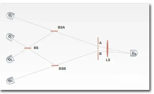

This page has a good simple summary of the experiment, they present the following simple schematic of a delayed choice quantum eraser (the same as Figure 1 in the original paper by Kim et al.):
In this case, if the entangled "idler photon" is detected by Alice at D3 or D4 then she will know whether the "signal photon" went through slit A or slit B, but if the idler is detected at D1 or D2, then the which-path information for the signal photon is "erased". Alice would be free to replace the beam-splitters BSA and BSB with mirrors to make sure all the idler photons were directed at the middle beam splitter BS, ensuring they all ended up at D1 or D2 and had their which-path information erased. She would also be free to simply remove BSA and BSB so all the idlers would end up at D3 and D4, so none of them would have their which-path information erased. And for a large enough setup, she can in principle make either choice after Bob has already observed the pattern of the signal photons that have passed through the double slit and been detected at D0 (D0's position is supposed to be varied to see how many signal photons it detects at different positions, but feel free to replace D0 by the more traditional "screen" behind a double-slit if it makes things more clear, the point is that this is where you expect to see either an interference pattern or a non-interference pattern depending on whether you know which slit the signal photon went through).

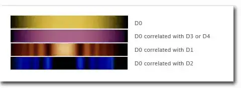

The key as to why this doesn't allow for FTL or backwards-in-time signalling is that Bob never sees any interference pattern in the total pattern of signal photons going through the slits, he can only see an interference pattern if he looks at the subset of signal photons that he knows were entangled with photons that ended up at one of the two which-path-erasing detectors D1 or D2. If you graph what the original paper calls the "joint detection" of signal photons with idlers that all went to D1, you see an interference pattern, likewise if you graph the joint detection of signal photons with idlers that all went to D2, you see an interference pattern. But even if Alice makes sure all the idlers go to D1 or D2 by replacing BSA and BSB with mirrors, the total pattern of signal photons that Bob sees at D0 will be the sum of signal photons entangled with idlers that end up at D1 and signal photons entangled with idlers that end up at D2--and the sum of the two "joint detection" patterns is actually not an interference pattern, because the peaks of the D1 interference pattern line up with the valleys of the D2 interference pattern and vice versa. This is illustrated in another diagram from the page I linked to earlier:

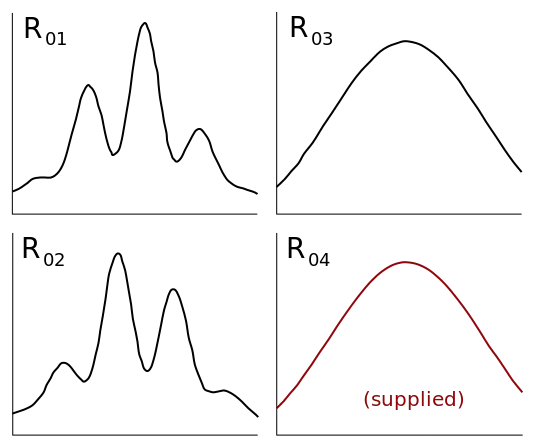

You can also see it in the graph of the R01 and R02 interference patterns on the wikipedia page:
The original paper by Kim et al. notes this issue on p. 2, saying "It is clear we have observed the standard Young’s double-slit interference pattern. However, there is a $ \pi $ phase shift between the two interference fringes."
So, regardless of what Alice does, Bob never sees an interference pattern if he just looks at the total pattern of signal photons arriving at D0, only after he has communicated with Alice and learned which idlers went to which detectors can he look at particular subsets of signal photons whose idlers all went to a particular detector, and see an interference pattern if that detector is D1 or D2.
