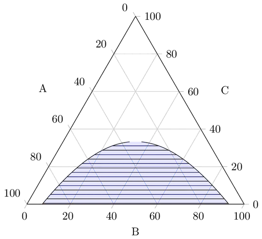

To actually go about solving the case at hand. one could assume $\varphi_\text{C}$ constant and then write $$\frac{\mathcal{F}}{k_BT} = \chi\varphi_\text{A}(c-\varphi_\text{A}) + \varphi_\text{A}\ln\varphi_\text{A} + (c-\varphi_\text{A})\ln(c-\varphi_\text{A}) + \varphi_\text{C}\ln\varphi_\text{C}$$ where for notational convenience I wrote $c = 1-\varphi_\text{C}$. The only thing that is then truly different from the two-component case is that the critical value for the FH parameter is $\chi = 2/c$ rather than $2$. Now obviously in holding $\varphi_\text{C}$ constant, we have assumed that the tielines should be such that the C component is in the same proportion in the two phases. This is indeed the case due to the symmetry of the system.
I have graphed the ternary phase diagram it below for $\chi = 3$ (horizontal tielines). Phase diagram

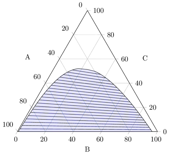

The analysis is also much more involved (at least my numerical implementation is) than the Small molecules case for two reasons: The system is not perfectly symmetric so it does not phase separate to two different free energy minima of the uniformly mixed system. Rather, one has to find the points with the same chemical potential, and then find the one that produces the wanted composition with the lowest free energy. Second, the tielines need not be horizontal, so there is another dimension with respect to which to minimize.
I have provided my code in Appendix A, with which I have produced the graph below with $N = 2$, $\chi = 3$. For your question I suppose the most important aspect of this is that the tielines are indeed not horizontal. Phase diagram
