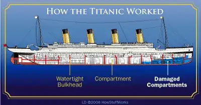

The Titanic was considered "unsinkable" because any four of the sixteen compartments could be flooded and she would still float. These compartments (see picture below) were basically vertical "walls" throughout the ship. If the region between any two walls flooded, the water could not flow to the other compartments (when the flood doors were closed). Think of it as 16 smaller boats welded together and you get the idea.
However, when you look at the diagram you will see that these "walls" didn't reach all the way to the top. The ship's designer was on board for the maiden voyage, and he told the captain that she would not survive - losing more than 1/4 of the buoyancy was just too much, and as the ship started to list water would start to flow over the watertight barriers, filling compartment 6, 7, ... So closing the doors would not have helped. They key was to get passengers off the boat - at which they did a terrible job (not only did they not have enough life boats, but the ones they had were not all filled because there had been really no proper training - after all, she was "unsinkable").
If they had not tried to avoid the iceberg, but had instead hit it head-on, then they would have destroyed the front compartment (maybe even two); but they could have closed the watertight doors, and the ship would have survived. The bottles on the shelf in the first class bar might not have because the impact would have thrown everything and everyone around quite badly.
For more details see this which is also source of this image:
The tragedy was that by attempting to avoid the collision they scraped the iceberg (most of which was underwater - there's the physics bit) and it cut open five consecutive compartments (actually - the force of the collision popped the rivets). This led to a lack of buoyancy which caused the ship to tilt - and the flooding water ended up above the level of the watertight compartments (which didn't go all the way to the top) so other compartments could flood.
It is probably true that leaving the watertight doors between compartments open slowed the process of tilting. Once the ship reached a certain angle, stresses became too large (bending force from the front trying to sink and the back trying to float). It is believed that the boilers (remember this was a huge steam ship) broke loose and "fell" through the length of the ship, punching a hole as they picked up speed. The hull may also have snapped in half as the bending stresses were far greater than she was designed to withstand. At this point, the electricity generators failed, the hole in the hull became massively bigger, and the whole thing was over in seconds.
