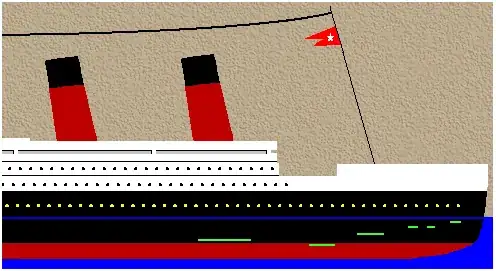

There were multiple small gashes far below the water line - where the rivets popped due to the stress of the impact. Based on investigations of the wreck, this is roughly what they might have looked like:
The draft of the ship was about 34 feet (10 meters), putting the deeper gashes about 6 meter or so below the water line. The fractional change in pressure that you could effect by any maneuver to raise the bow / change the profile of the water line would be at most 2 meter (being generous here), which in the very best case would have slowed the sinking by an hour. Tops. And in the process I am not sure what they might have run into, going backwards.
I hope someone has a hydrodynamic model to put a better confidence interval on my "two meters tops" number. I expect that it is very high.
