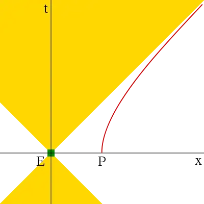

Accelerating Observer
Could P possibly observe Hawking radiation coming from behind?

Yes, P will observe a thermal radiation that is locally identical to the Hawking radiation and it is called the Unruh radiation. Its temperature is $a/2\pi$ in the $\hbar=c=k_B=1$ units.

Finally, let's mention that OP's original picture - a way of dividing the Minkowski space by an event horizon for an accelerating observer - is known as the Rindler space:
http://en.wikipedia.org/wiki/Rindler_coordinates
The event horizon for the observer is observer-dependent and is also known as the Rindler horizon.
