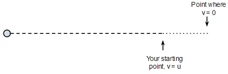

This is only a partial answer but for gravitationally bound objects, i.e. the kinetic + potential energy < 0, you can simply use the equation you already have.
If you start at a distance $y$ with velocity $u$ simply find the distance $y'$ where the velocity would be zero:
$$ \frac{GM}{y_0^2} - \frac{GM}{y'^2} = \tfrac{1}{2}m u^2 $$
Then use this value of $y_0$ in the equation you already have.
