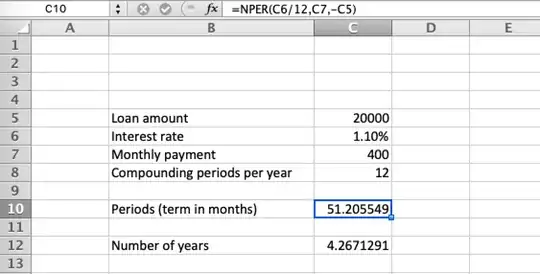

Also in Excel, as suggested by RonJohn, documented here, the same result:
