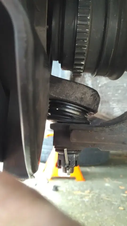

  1. I needed to install a washer between the castlenut and the arm when torquing the balljoint. This is because the castlenut could easily be tightened past the hole for the cotterpin. I recently changed the balljoints and again encountered the same problem. (The boot also looks a bit smashed to me)
After replacement of the balljoint and control arm

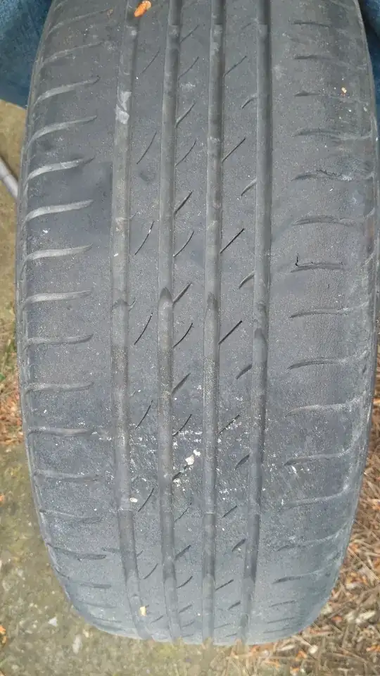

  1. I have had a problem with positive included angle and camber. It seems as though the control arms are just slightly too short!? Here is the front-right tire (after ~60,000 km):
Tire ware on outside edge

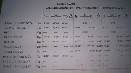

Here is the alignment that I did after replacing the control arms and tires:
The left column are the tolerable norms. The middle is before the alignment and the right is after. The terms are the following:
  • CARROSSAGE = camber
  • CHASSE = caster
  • INCLIN. PIVOT = Steering Axis Inclination
  • ANGLE INCLUS = Included Angle
