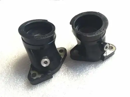

1. Rubber Intake Manifolds - Most modern motorcycles (Mid 1970's on) have rubber manifolds attached to the cylinder head. The carburetors fit into these manifolds and are clamped. Over time they become hard, brittle and cracked and suffer from dry rot due to excessive heat at an accelerated rate.
  • Cracking can create air leaks which create lean conditions.
  • Poor assembly accounts for another large portion of air leak created issues. Make sure the carbs are seated in the manifolds properly. When inserting a bank of 4 carbs into a 4 cylinder it can be very difficult to get them to seat right. Use a bit of oil in the inside diameter of the manifold to help them slip in easier. Tight the outer two clamps initially in stages before starting on 2 and 3.
  • Vacuum Lines Not Attached is very common. Leaving a petcock vacuum line off can create a lean condition on 1 cylinder but normal on the rest. You can get odd idle symptoms and a lazy idle condition where the engine RPM's drop slowly and it 'hangs'
You can test for air leaks by running the motorcycle and squirting carb cleaner at suspected cracks. The idle will reduce a bit if you hit a winner. As well, you smell a sharp odor from the exhaust as it is pulled through the motor and undergoes combustion. Don't breath much of that in and use fans while doing this. If you don't feel comfortable with carb cleaner you can use an oily thicker spray like WD40 that will clog the crack better temporarily and reduce the idle. I'm typically looking for the odor though, it's sharp and pronounced and unmistakable as opposed to, "did that idle just drop a bit, let's do it again..."

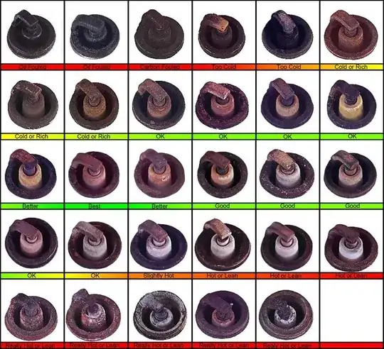

Sparkplugs Are Your Breadcrumbs
Again, refer to the sparkplugs. Look at the chart. See what you can see. If you have a multicylinder bike and multiple carburetors you will NEED to check ALL of your plugs. Each carburetor can have an individual issue.

A shop manual (particularly one with colour photos) will offer some spark plug diagrams / photos, to compare against your plugs, but they're not particularly useful.
