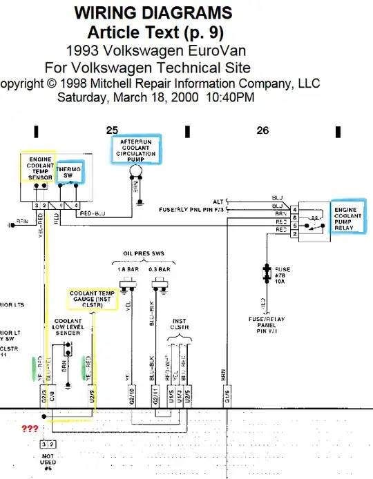

If you look at page 9 of the wiring diagram below, it looks to me like the engine coolant temp sensor is connected to the coolant temp gauge (instr clstr). I marked both in yellow.
I noted (using green lines) that both the wire coming from the engine coolant temp sensor and the wire going to the coolant temp gauge are YEL-RED (meaning yellow with a red stripe), so I am fairly confident that that the coolant temp sensor only is used by the temp gauge on your dashboard. As a result, I do not think the coolant temp sensor is causing the engine to overheat.
Wiring diagram page 9
Note: You can see I also put blue boxes around the different parts of the afterrun coolant pump. This is a pump which cools the engine's turbo after the car has been shutdown. It is an electrical pump, whereas the primary coolant pump is mechanical. If your engine has a turbo, the afterrun coolant pump cannot cause the engine to overheat.
