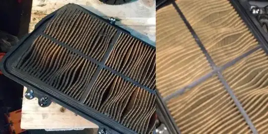

Update: I took out the spark plugs and the air filter. Cleaned them a bit with a wire brush for the former and compressed air for the later. Retightened and checked all the parts I could get at following this guy's excellent instructions.
Air filter, before and after:

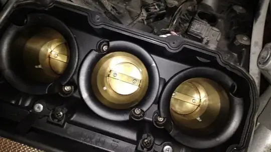

The throttle body plates I didn't touch, but they didn't look too dirty to me:

The result of this work: nothing changed, the bike runs identical to before messing with it. But now I need to see what that check engine is on for - probably just need to erase the error, right?

Sounds like a lean condition
Here's something to chew on regarding identifying a lean or rich condition on a motorcycle.
What I believe you are hearing is backfiring. It isn't loud because the baffling systems on modern motorcycles are so effective.
If you have a lean condition that suddenly appears out of nowhere I would check these basics.
  • Vacuum lines. If you have a vacuum line come off, it will add more air to the system and create that lean condition.
  • Manifolds - Perhaps one of your manifolds has a crack in it. Also, check the metal bands that wrap around the manifold and tighten down to hold your throttle bodies into place and ensure they are not loose allowing air to slip by.
  • Manifold plugs - I'm not sure if your model has these but there are stand pipes on many rubber manifolds that are brass. They will be capped off with a little rubber cap. They are taken off for maintenance and used to measure manifold pressure and synchronize the throttle bodies. Make sure the plugs are capping the stand pipes off.
  • Air filter - This one is a reach. See if your air filter is properly placed in the airbox and hasn't come free allowing more air into the system and effecting your AFR.
Anything I've missed regarding air leaks is what you will want to inspect. Vacuum lines for the emissions system, a fuel diaphragm, etc. Perhaps a torn air filter (reaching again, I've only seen that once in my life).
Edit
  • Loose sparkplug - A loose sparkplug could be backing it's way out of the threads. You can have a lean condition as it begins this process. Double check that your sparkplugs are nice and secure.
