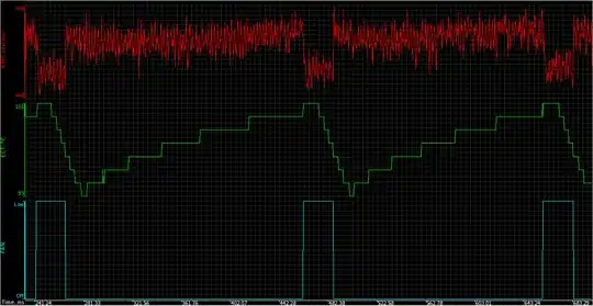

So I hooked it up to ForScan to gather some data. The lines are RPM's, Temp and Fan On / Off ( X axis is time in seconds ):
Basically, when the ECU is reading about 97-98 C* is when I start to see the coolant in the expansion container expand. By the time it reaches about 100C* ( 212F* ) the coolant is bubbling and overflowing the container. About the time the fan turns off the coolant recedes rapidly. About 20 seconds after the fan turns off the ECU reads about 92-93C*.
The fan is on for about 35 seconds each time, and about 190 seconds passes before it comes on again.
Now as to why this is all happening. I can think of a few possibilities.
  1. Maybe I've got a partial clog in the engine block water jacket? I've flushed everything backwards and forwards multiple times and water seems to flow everywhere without any problem. I installed a tee on the heater core outlet and pinch off the top radiator hose to force the water backwards through the block with thermostat and lower hose removed.
  2. Slightly off Temp sensor? I've taken out the ECT and tested it and it seems accurate, although I guess it could be off by 5 or 10 degrees and I may not have noticed.
  3. Radiator Cap could be bad, it's old. 1.1 is written on it. I assume that's probably bar. I would think the temperature would need to be much more than 97-98C* before there would be sufficient pressure for it to start opening and letting coolant out.
Two side notes. I'm currently running distilled water, but it was also happening with the green Prestone coolant which is rated up to 126C*.
The dash temperature gauge has gone wonky recently and is usually pegged low or bouncing around randomly, even while the ECU reports a steady, normal temperature.
As a reminder, this doesn't happen when the A/C is on.
I'd really appreciate everyone's input.

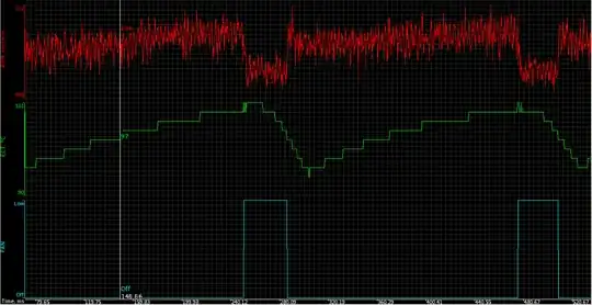

PostScript 18/7/2017
So it was in fact the radiator cap. Thanks to zipzit and SolarMike for their great answers!
Here's a new graph with the new radiator cap installed:
Even when the temperature hits 101C* there is no evidence of any movement at all in the expansion container. Also, some other things have changed. The fan stays on for only 24 seconds and 195 seconds pass before it comes back on, which is about a 1:8 On/Off ratio now. And it only takes 13 seconds after fan shutoff for the temperature to get down to 93C*.

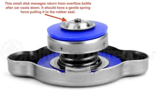

My guess is bad radiator cap. The cap has two sealing systems. One that holds high pressure (13 to 15 psi). Water at 13 psi doesn't boil until 245 Deg F it so. The other sealing system is the overflow return. As the engine cools down this allows coolant from the overflow to return to the radiator. My guess is that little valve is stuck open.
I'm also guessing you are located at a high altitude causing you to boil off coolant well below 212 Deg F. ( boiling point of water at sea level)
Inexpensive fix.
Edit. At 900 meters of elevation the boiling point of water is 206.2 Deg F / 96.2 Deg C. That's in the normal temp range for your engine. So yes replace cap immediately.
You can probably see the defect in the radiator cap visually. Do note: The way that works is after vehicle cool down, a slight vacuum is formed in the cooling system. That vacuum "sucks" extra coolant out of the overflow bottle. Note: While it takes 15 or 20 minutes to heat up the cooling system, it takes a LONG time for this cool down vacuum return thing to work, generally eight to ten HOURS after vehicle shutoff.
radiator cap with flowback sealing plate
