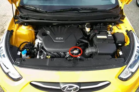

  • My guess is you have a bad radiator cap. The cap on your vehicle has two seals. One used for high pressure relief, the other a flow back valve that sends coolant from the overflow bottle back into the radiator. Your flow back valve is shot.
  • Location of the cap: Radiator Cap on Hyundai
  • See photo and response to this question for more details.
